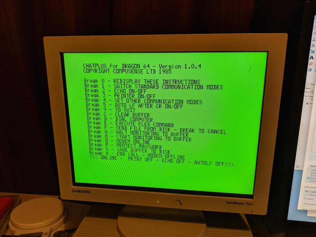

I know this is an old thread - is it really 4 years since we had this conversation? - but I've actually made some progress!

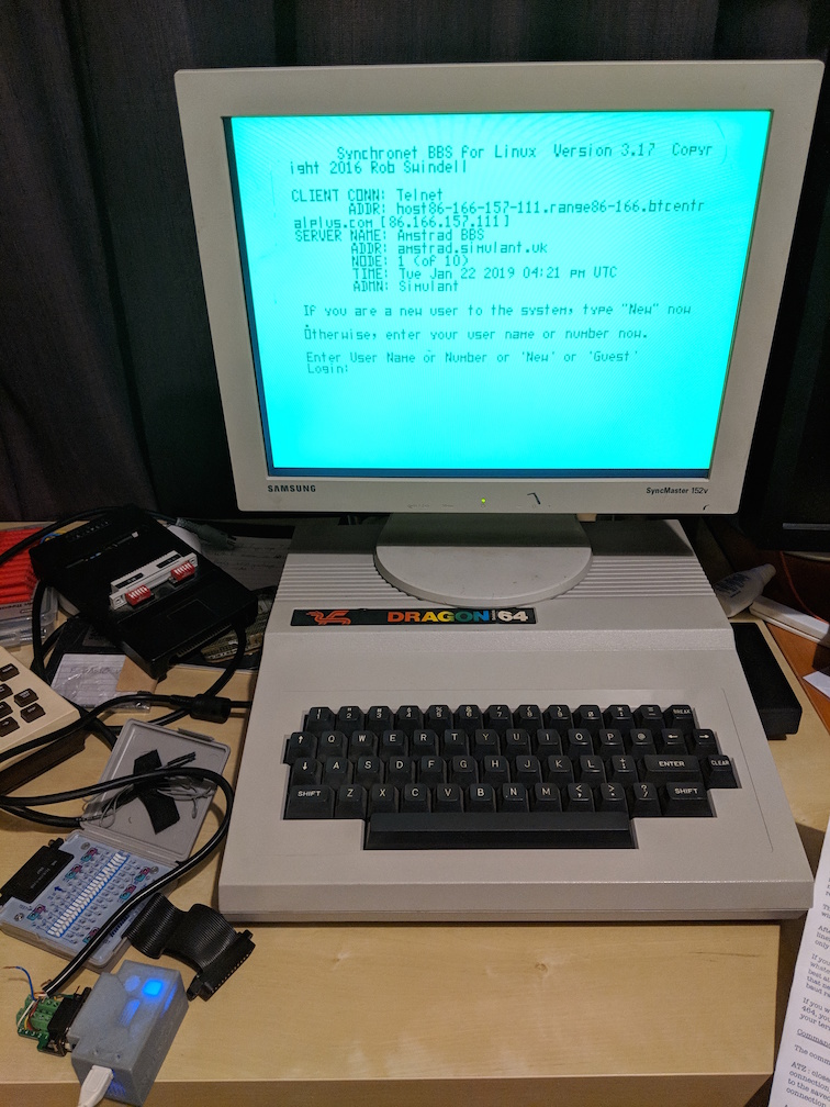

Since we first talked about this, I've got a CocoSDC - I put Flex v1.3.2 in the first drive, ChatPlus in the second, booted, did a "1.CHATPLUS.CMD" at the Flex prompt - and bob was my uncle! See attached picture number #1. I then set a baud rate of 1200, plugged in my little WIFI-modem and I'm online. This version of Chatplus seems quite primitive - seems like a very dumb terminal, not sure if it's actually emulating anything.
What I'd really love is to get access to some of the Viewdata services out there (telnet glasstty.com:6502), and I see that Compusense are advertising a Viewdata program for the D64 in April 1986 - https://archive.org/details/dragon-user ... 36/page/n1 - but I don't see it in the archive. Anyone got it?
The other option is to get the Peaksoft cart going (you can see it in the second picture) - I know that's got Viewdata software in it (I've dumped it here - viewtopic.php?f=7&t=5721 ), but it's not designed to work with D64's serial. Or at least, I don't think it is. A manual for that would be really useful!
