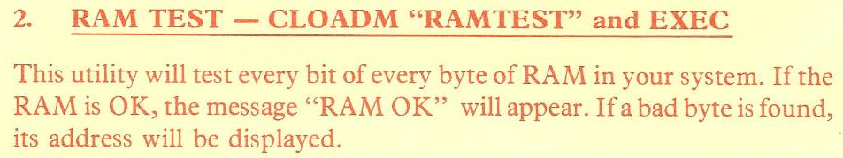

Programmers Utilities by Microdeal includes a RAM test program. The downloads section of the archive has a cas file but I will also include the wav file of just the RAM test program here. I hope this is of some help.
