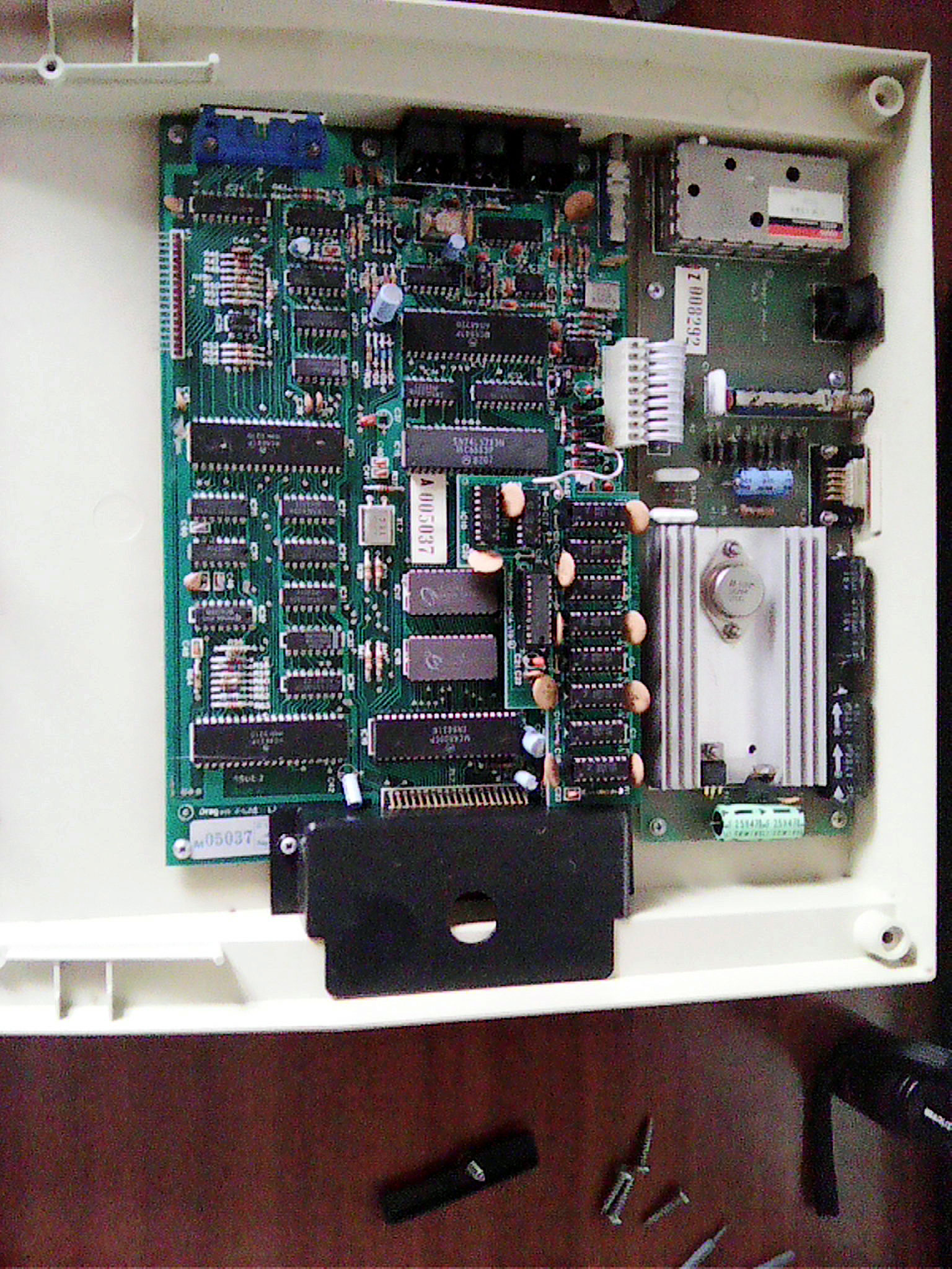

The flash I described initially was a horizontal band across the middle of the screen, like a faulty suppressor used to create. I have a photo of the board but how do I upload it?

Thanks Alastair, I just dragged the pic into the message box as you said - easy when you know how.D32 board
D32 board
D32 board

It seems that you are almost there. That looks to be an Issue 2 board with the two banks of 16k chips -one above the other.
The voltages that I was suggesting that you check were all on the grey connector between the PSU board (on the right in your picture) and the main board and are DC voltages coming off the PSU board. Pin 1 is at the bottom in your picture. But no matter, it appears that the voltages are all there and the power switch is a bit "crusty". So try contact cleaner next.
